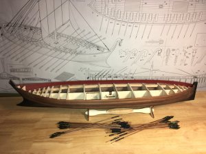

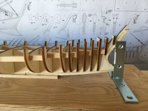

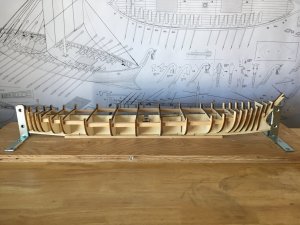

Keel has been glued together, rabbit cut and spacers installed. Spacers can be removed after fairing if you so wish

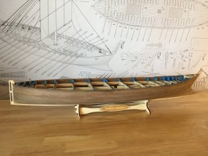

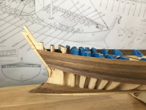

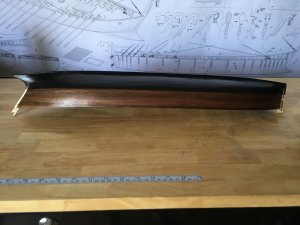

Masking off for the waterline

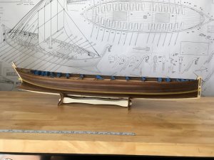

Deck planking has started, using 1.5 x 7 mm planks

Top rail installed

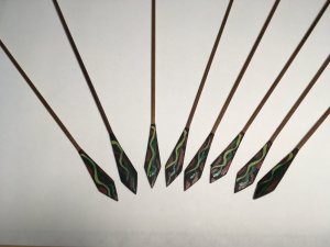

Cutting out the oar ports, I made a little stamp to show positions and shapes of the ports

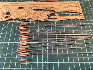

Standing rigging completed and oars stowed
Rigging completed

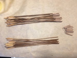

Novilara completed. I will stow the oars later this is just for pictures
Thanks for looking in and I hope you enjoyed
