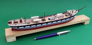

After 49 hours work (timed on a stopwatch), spread over 32 days, the hull is now complete, and all ready for the masting and rigging. The hardest part is now over, as rigging these miniatures is far easier than making the hull and deck details. The ship will be shown in a sea, under full sail. I have already assembled the display case, but not veneered the edges yet. The sea and sea base have also been made, but not finalised yet. This model has followed the usual path as far as interest by fellow ship modellers is concerned. Namely, a small number who are interested, to begin with, but trailing off as the build progresses. Merchants ships (so I am often told), do not possess the appeal of warships, and therefore, we do not often see many models of them!
