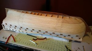

WOW! I finally made it back!!! :p:D:p:D
My friends always ask if I've been working on my ship, and I have to sadly say, "No", but today I actually had a little time on my hands, so I uncovered Ingermanland and laid a few planks to the hull. :D
Because of the laser cut planks, I've been labeling each one as per location and side. This way I am able to remove them from their wooden sprue. At that point, I'm free to sand/shape each piece, in mass, prior to install, thus allowing for a smoother assembly...when I actually have the time to work on it :confused:
I'm really looking forward to shaping the hull for the final planking, and as you can see, I'm almost to the point of having the hull closed up with the false planks! The hull, at this point, is unbelievably solid sounding when I knock on it. lol
