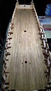

This morning I am happy to say that I have completed the planking of the first deck!!! :D
I DID IT!!! :p:D:p:D:p
There were times when it was a real pain in the rear, but I must admit, I enjoyed every minute of it. :D
So, here is my next question...
What works best for cleaning the deck?
I have s few areas that have pencil smudges and I'd like to clean them up before varnishing.
And would you suggest sanding the deck a bit? Maybe with 220 or 320 grit?

Give it a try ,how thick the planks are?
0.5 mm's. I just used a razor blade and it worked perfectly! And it even cleaned it up well, Zoltan. Thanks for the help!!!
Just don’t scrape it too much at 0.5 mm,,you could scrape away the planks,I used 1 mm thick
