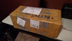

Opening the shipping box was a real treat! There are three rather large boxes for this kit, and, in total, they weigh about 35 pounds. It's a very professional looking packaged kit as well. Very impressive!
Opening each box was an even bigger treat as each one was filled to the top with well stacked goodies! It comes with an instruction book, detailed drawings, and everything needed to build this beautiful ship (minus tools, glue and paints of course).
