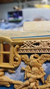

While waiting for my veneer set I started with the outside carved railing along the top of the ginger bread decorations on the side.
The originals are quite thick 3,5 mm so first I sanded these down to 2 mm on my preshistoric belt sander.
The second step is then to clean out all the compacted dust from the carving cnc milling process which is ver time consuming. I do this by pressing these out from the rear side to open up all those tiny spaces.
On the top the rear sanded and cleaned, the bottom one is the rear side as supplied.
And the front side of both cleaned and uncleaned.
Time to fit them in place. This involves a lot of cutting, sanding and fitting.
Finally one side is fitting, now the other side followed by waxing and polishing and finally fitting.
But first the stern part cutting sanding and fitting.
And the finall result below.
Again the same procedure for the PS side.
