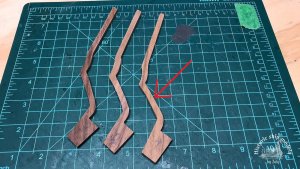

Very good progress on one of the complicate parts of such a ship.
And we can see, that today you had the chance to work some hours on your model, sharing with us in time your different working steps.
One small question refering your stern timbers...did you use a sort of plywood or is it solid timber?
Due to the fact, that you cut the timbers in one piece, isn´t there the possibility, that they breack in the direction of the grain, biggest problem is maybe at the center.
So if they are no plywood be careful.....I made a red arrow at the area where I think they could break if there comes some sudden force from the side.

Hello Uwe ,the stern timbers are 4 mm thick walnut ,very sturdy and solid,I have tried to put some pressure on it to brake where you marked it but no success.
The stern plate will be glued to the stern timbers, so no problem .Thanks for your input.
