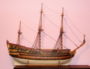

I'm posting this show what you can build for a few dollars and a little bit of creativity
I started building this model 40 years ago, we had just migrated to Australia and money was very tight so I could only afford the plans and I had to use what ever I could to build the model, I bought the Lanterns and deadeyes, the model cost approx $50 to build

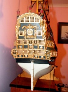

STERN VIEW

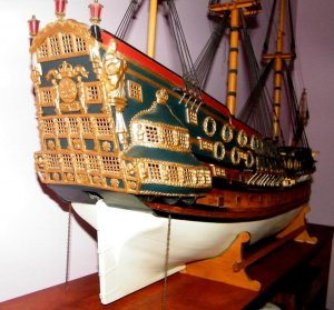

another view of the stern

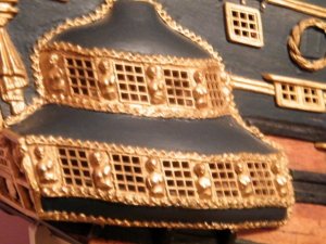

side galleries, the figures were cocktail forks which I cut down and used on various parts of the ship, the windows were a plastic mat that some ladies use to make place mats with, they sew wool through the holes, if you know what I mean
