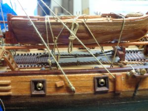

Aug 11, 2018
17
13
#1
I have been getting some fuzzy lines lately as a norm I wax all the lines, lately I have tried soaking them in water diluted with white glue then waxing. I have allot of different types of line in the supply locker hemp, synthetic, treated, untreated, ect not a big fan of the newer synthetic stuff so I order from several different companies. Difference in quality could be the problem ? I do have some really old line which really looks good but will fuzz up even after waxing. Bottom line is I need to try to treat some of the lines already rigged, and find a solution for the new line. any help or Ideas would be greatly appreciated. Notice the fuzz in the outboard hull lines in the photo MOG

I've been away from the hobby for quite some time, In the past I have seen this difference between cotton, cotton/poly, and linen threads. The 100% linen never fuzzed after drawing through bees wax. As for the riggged line, I would try bees wax bead or buttons and try to gently redraw the lines through.
Below are the bees wax I'm talking about. they come in white clairified also.

Thanks for the advice. As stated I use allot of different types of rigging line, Amiti, coldercraft, Billing ect. my last build had little to zero fuzzy lines, taking a hard look at the current build only a few lines are fuzzy, so it looks like its down to a certain type of line which I will single out for some trial and error work. As far as the wax goes I have used it for years with no problems, for me anyway it makes the line much eraser to work with. My current wax block is getting old and grainy, so I will replace it, Thanks Wesmaine the beads & buttons look good for reworking the already rigged lines . which needs to be a very delicate process. however, I’m always looking for new ways, so all advise is appreciated. Side tracking on cases, I build my own which is cost effective, I use plastic instead of glass, less weight, and does not break. Case or no case dust is something we live with, however once in the case the dust is not that bad, of course the environment you live in has some say about it. So, every so often I use a small air duster to give them a clean. Plus, a case protects your precious work.

Again thanks to Wes for the change in wax idea. So far the rewaxing of the lines is getting rid of most of the fuzz, not much I can do about some of the lines in very tight areas. After looking at all the line I have on hand I think I found the problem, Cotton line , trying to find the right size and look it appears I rigged with some areas with cotton line. The up side is I only used it a few times, said cotton line has since been removed from my supply' locker.
