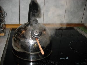

I came to the conclusion that one can't work without a pattern when bending. I make a template,
fasten it on the board, then, I steam up the workpiece in the tip of the boiling
kettle. I take it out and with the help of a wedge I press one end of the workpiece to the template,
after that, I bring the workpiece with template to the tip of the boiling kettle and warming up the workpiece over a stream of steam, with little effort,
I start pressing the workpiece to the template profile, often fixing it with wedges to
the template, and going on so until reaching the end of the template.
So as not to burn hands, the workpiece must me longer than the template.
It's going to work out this way. I was amazed by how bending the wood becomes under the stream of steam. I had to buy an ordinary classic kettle for that.:)) IMG_0038.JPG IMG_0044.JPG IMG_0047.JPG IMG_0052.JPG IMG_0438.JPG IMG_0467.JPG IMG_1266 (1).JPG
