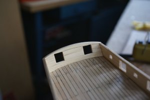

After the inside planking of the bulwarks complete it was time to add the stern transom. The piece supplied in the kit did not fit no matter how hard I tried. Don't ask me what kind of wood that is, it is the kind of "available wood". It fitted, so glued in place it was...

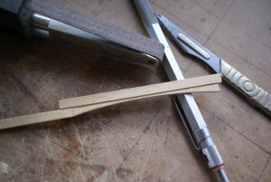

The inside planking of the tramson gave me some matter of thought, I was born near the sea, there were a some naval yards that made mainly fishing boats and as a boy I visited the yards some times. I remember that the planking of the transom was made of curved planks, following the curve of the deck and just for fun and as I thought it would be more real, I tried to do the same in tne model.
Glueing two planks top to top gave me the necessary width to make the curved planks. How acurate they are, I don't know, as I said before I ignore everything in this ship except that it really existed and some other details of lesser importance...
Anyway, here they are:
and in place (and the rear ports opened)
In the photo the union between the two planks shows a little, but if is very amplified and they are hardly noticeable.
I must say I like the effect.

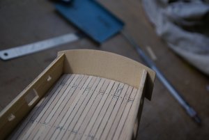

How don't know if this happens with every kit or just this one, although the Charles W. Morgan has exactly the same problem, but the stern is the less documented part of the model, what is a problem because I can see that is one of the mosf difficult to get right. Some photos or sketches should be very helpfull if provided, as it is a lot of guess work. Thinking ahead can help but with my short experience a lot of trial and error must be envolved.
I had absolutely no idea how the damm thing should look like I only know that if I followed the instructions I would end up with a pretty mess.
Constructo and Artesania Latina, (the ones I know) should be more careful with the instructions and give useful views of what the finished thing should look like. At least have some more consideration for the fellow who buys their kits.
As things were I had to invent my interpretation of what the transom should look like, it is not flat that I can see.
I think that the piece that I added to the transom allows it to al least to look real.

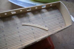

Correcting some faults in the transom.
Work on the part to mend the stern
In place and with the exterior planking.
adding the lower (darker) planking to the stern
... with the curved planks. I can't figure straight planks there, maybe I'm wrong, but it looks much better to me.
