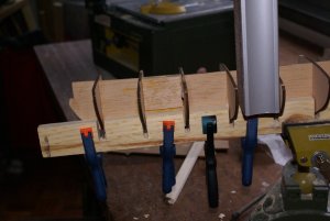

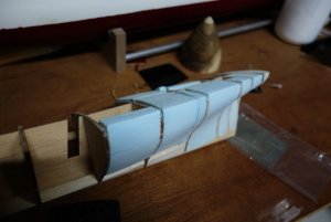

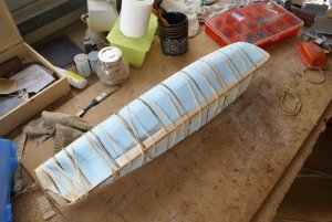

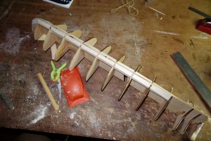

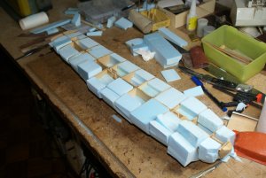

Thanks for following. Yours is a pertinent question and I thank you for asking. It is blue foam and yes, I think it was a good idea.
Apart from a Drakkar, this is my fisrt ship building and although I have some experience in model airplanes, ships are a different matter and I had no experience at all. Some reading, some browsing in the net and some thinking, that was all
This particular Constructo kit had the keel and bulkheads made of thin ply and it kept twisting even after gluing the all skeleton together. I tried to give it some rigidity using balsa. Even so it was not that rigid.
Besides, I thought the ship had only one plankig. Instructions did not mention the second plankig, neither the pictures nor the written instructions. Only latter did I discover the wood for that second planking, but than it was too late. It would be a very difficult task planking the hull with hard wood if it was not very firm.
