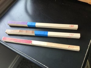

Sanding Detail Tool.
I noted in one of my posts that I had made sanding sticks from 3/8 x 3/8 in square Birch stock. I cut the Birch stock about 9 in long and cut various grit sandpaper in 3/8 strips 4 to 8 inches long to fasten to the stock. For the heavy grit sandpaper I used a Elmer’s glue stick to fasten a 4 X 3/8 inch piece of sandpaper on only one side of the Birch stock. For the finer grades of sandpaper I folded 8 X 3/8 inch sandpaper strips around the Birch stock and held it in place with blue painters tape. The sanding sticks were made to clean up the gun port openings after the openings were drilled and cutout.
Searching the internet for some replacement lumber I found the Sanding Detailer. I ordered a set and used them to do the final sanding on the hatches, capstan, ladders and the last four gun ports. I found them easier to hold and able to get into the corners better than my DIY sanding stick. The various grits of sandpaper supplied worked quite well. The little sanding belts move easily to provide a clean surface for sanding. The sanding belts can also be replaced quickly and easily. Overall I’m satisfied with the product.
