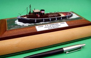

#9
No, because it is not finished yet. I need to make the oars for the lifeboats, French Polish all the base and display case veneer, and paint the sea. They are all built in a similar manner anyway. Here is a FREE download link that contains plans and general instrcutions for building the tug SA Everard. https://payhip.com/b/krO6 When the link opens, scroll down a bit to read the synopsis. Under the image, there is a download button labelled "This item is free!" The synopsis has now been read 8,032 times, but only 405 people have actually downloaded it. Several have successfully built the tug without any great difficulty, but I don't know about the other 400! o_O
Bob
