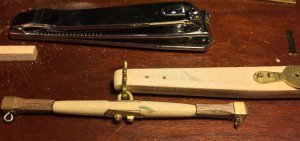

G grayson72 Joined Oct 18, 2017 Messages 21 Points 48 Location Sacramento, CA Aug 21, 2018 #21 Here's how I rounded the square blocks: Last edited: Aug 21, 2018
G grayson72 Joined Oct 18, 2017 Messages 21 Points 48 Location Sacramento, CA Aug 21, 2018 #22 I needed to replicate these plates on the single trees: So I used my cutting machine to to cut out the shapes on a very thin brass sheet: Last edited: Aug 21, 2018
G grayson72 Joined Oct 18, 2017 Messages 21 Points 48 Location Sacramento, CA Aug 21, 2018 #23 I also needed to replicate these details on the end: Here is the unpainted product:
G grayson72 Joined Oct 18, 2017 Messages 21 Points 48 Location Sacramento, CA Aug 21, 2018 #24 And then the finishing process begins: Primer Color coat: End Detail: Final details:
G grayson72 Joined Oct 18, 2017 Messages 21 Points 48 Location Sacramento, CA Aug 21, 2018 #25 On to the double tree: Here I'm trying to replicate this top plate. Didn't quite get the same shape.
G grayson72 Joined Oct 18, 2017 Messages 21 Points 48 Location Sacramento, CA Aug 21, 2018 #26 Here I try to replicate this bracket which holds the single tree to the double tree on the front and a chain to the front axle on the back. I start with this thick brass wire: Then I flatten, file and bend it to the shape I want: Here's a dry fit onto the end of the double tree: Here's the single tree attached to the double tree with the bracket. Last edited: Aug 21, 2018
G grayson72 Joined Oct 18, 2017 Messages 21 Points 48 Location Sacramento, CA Aug 21, 2018 #27 There is a step on each end of the double tree: Here's my version:
G grayson72 Joined Oct 18, 2017 Messages 21 Points 48 Location Sacramento, CA Aug 21, 2018 #28 Putting all the pieces together after paint: Steps and pinstriping added: On the model: Last edited: Aug 31, 2018
