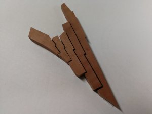

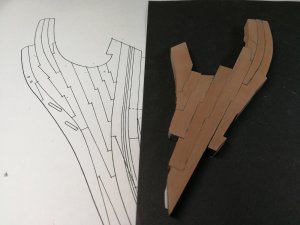

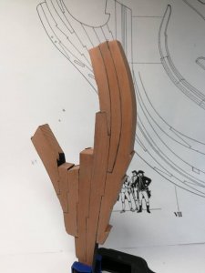

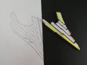

In the frist step i milled the first pieces from the keel an i started with the Forefoot an the. Sorry, maybe the term ar´nt correct. I try to learn the correct terms
with the 74-Gun-Ship Book from Jean Boudriot.

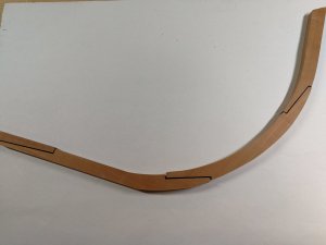

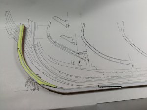

The forefoot seem more comlex than he is. Its smole to mill the linear sufaces. The problem are the convex and the concav curves and the fitting between two pieces.
In one or two pieces you have a line and a curve togehter, which is more comlicated. I sand this aras with a paper and a spindle grinder but to get a good result need to much time.
I will try to saw the curves with a little jigsaw. I get the tip from a another forum and seems that this is the way to buuil pieces like this.
So far so good. I hope anybody find this posting interesting and can learn from my failures.
