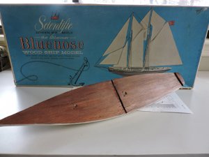

I stumbled upon this kit on Ebay and the price was right! I thought I would try my hand at my 1st wooden kit and went with a solid hull model. I noticed that this schooner seemed to have a lot of builds and information online. My wife was kind enough to purchase Frank Mastini's book "Ship Modeling Simplified", which I'm very grateful to have as a reference. When it arrived, whoever originally owned it had already adhered the two decks to the hull and did not make a clean cut in doing so. They had also cut through some of the pieces and some pieces of wooden parts were missing. This explains the 'great deal.

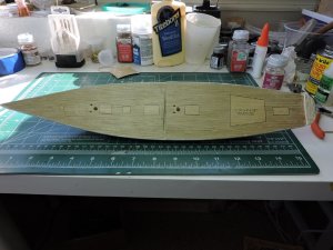

No worries - I was lucky to pick up some basswood strips and sheets at Joann's and started in on this project. First, I used different grades of sandpaper to smooth out the hull. I then used Elmer's wood putty to fill in gaps and dents in both the hull and keel. Then re-sanded, primed, re-sanded and primed. I then went on to shape the rudder to the hull and primed as well. I tried to clean up the cut mark on the deck and stained the deck with Cabot's Autumn Glow stain & sealer.\

Here is the deck after staining. I wanted a warm, darker color to contrast with the white/grey fittings on deck. I have added my side rails and stancions at this point. *I realized that there should have been more stancions than what I have, but the plans to this kit were very vague. It was not until I started to look closely at other models that I noticed the difference. My scuppers are also not an 'accurate' depiction but it is what it is.

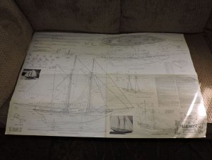

The one-page plans were a little unclear as to how to attach the rails, stancions and monkey rails to the hull. I finally got some advice from two other modelers and I got them in place. A little more putty work to hide the seams; shaped the rudder; more primer and masked off the hull for her paint job.
