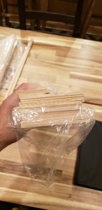

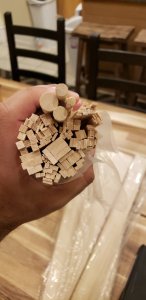

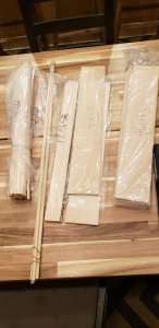

This is the beginning of my build log. I'm still working on finishing up my Longboat Build: 18th Century Armed Longboat but I've been gathering materials for the cross section build so I figured I'd start posting.
I printed all the materials and put them in a binder. I still need to print the jig prints but everything else is ready to go.
I went back and forth a lot on what wood I wanted to use, I wanted to do some nice stuff but after pricing it out it would've been over $200 in wood and considering this is my first scratch build I felt that was probably excessive. So I went with Basswood from Model Expo for $85 for everything I needed.
