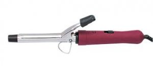

Yeah I use a curling iron but the wood crushed down when it comes in contact with the iron on the inside of the bends. I have the technique down my problem is the soft balsa like plank wood. I think the wood issue is due to it being laser cut it's getting so dried it its extremely brittle. The wood given to plank with is called Paulownia

These curling irons ?
curl.jpg just rub back and forth across it. no damage to wood.
