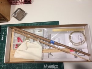

The kit is from Amati, scale 1/35, called Bireme, Greek Warship
Content of the box is not too "crowded", instructions, small peaces, ropes, planking material...

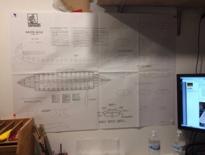

Instructions are not the strongest feature of this kit; they are written on three languages. Two big peaces of instructions my work space wall will not be able to handle both at the same time.. So need to get a bigger workshop :)

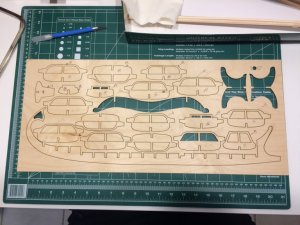

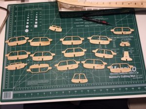

The laser cut process is very precise and leaves not to much residue to be removed after you cut off all peaces...
The important part is to mark all peaces before you remove them so you will know which frame goes where...
All marked and removed for further assembly...

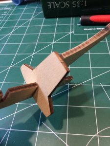

But i also planing to build a "ram" following some historical pictures which, hopefully, will cover most of these small imperfections..

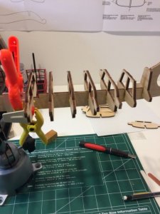

So i started to glue frames, finally. Making sure that frames are installed with correct angle, i improvised with some old mounting gear for a Ikea curtains. They are working OK but i think for future build, i am going to "borrow" few Lego blocks from my son' huge collection... Hopefully he will not noticed (i doubt it already) :)

It looked straight at the first glance but the second frame was a bit higher that the others. I corrected that with a help of acetone and "jolly good pull".

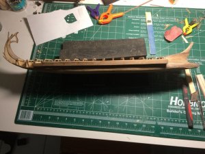

Today i have done a bit of a planking on the stern area. Was trying to come up with a plan how to do planking that might be as close as possible for planking job done during Greek era.. Planking plan that comes with the kit is not quite meaningful (or maybe i dont read it properly) so i tried to twist a plank to follow the shape of the stern. I had two planks designated for this job, had them in the water for two days to soak enough to make it possible to twist. Tried and did not work. So, bellow is planking decision...
The opposite side of the stern done in the same manner.
Here how it looks from the top..
Today i started to work on oarsman' seats.. Made a copy of plan so i can cut the seats shape and transfer it to the wood. I cut the individual seats, use scotch tape to glue them to the wood and cut individual seats..

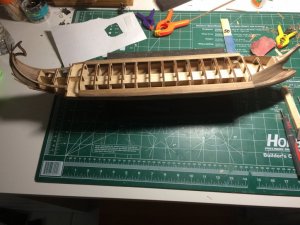

Well, no much to report today. Keep making oarsmen' seats...
Uh, now i have to deal with those yellow glue extras, leftovers from gluing hull planks. Those might not be that visible but i will know where to find them, so ...
During dry-fit, i noticed that 11th seat is a bit short and need to be extended for about 3mm.. I was expected if i cut the template from the plan, the final product should fit OK, but..

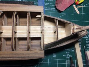

Today i completed the second row of oarsmen benches. I found out that if you follow the plan to the letter, you might ended up with benches that do not fit well..

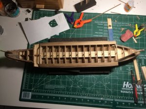

Then i started to work on main deck. Dry-fitting of main deck planks shows that a bit of a extra work has to be done. Basically few frames are lower than the others so i needed to add some blocks that will raise the height a bit.
This should be bringing the planks into nice, flat position once installed. Haven't started actual planking, this will be done tomorrow.

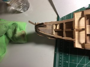

Here is the bow, it is not quite pretty but here i am planing to install a mighty ram that should cover the majority of that unfinished bow.

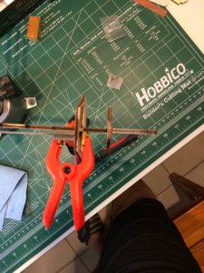

Also i made myself a small tool to help with plank twisting...
I am not happy with twisting results and had two planks put back into the water for another twisting attempt.
