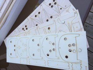

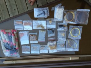

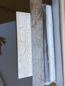

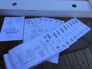

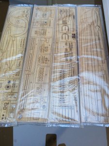

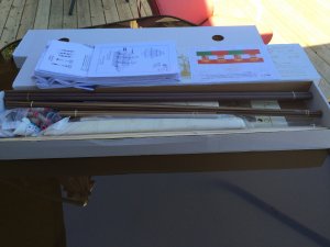

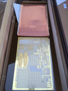

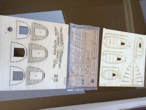

This will be my log for the Barque Stefano another fine kit from MarisStella. The kit is full of laser cut pieces, beautiful wood, photo etch copper plates and so much more. There are some 33 sewn sails including the stun sails. He is a boat with a beautiful shape and wonderful lines. MarisStella really went out of their way to make this a first class kit.
I have already started this kit but am far from complete, so I will race through the first part to bring you up to date then I'll carry on with my turtle like pace.
It is my intent with this kit to build it as is with no changes on my part and to also build it with all 33 sails flying in the wind.
IMG_1199.jpg IMG_1200.jpg IMG_1201.jpg IMG_1202.jpg IMG_1203.jpg IMG_1204.jpg IMG_1205.jpg IMG_1206.jpg IMG_1207.jpg IMG_1208.jpg IMG_1210.jpg IMG_3138.JPG
So this is the contents of the box and a picture of how mine may look, next I'll start with the build.

great to see, that you started the building log of your barque. Many thanks for sharing with us.
May I say some words about my impressions looking at your good and detailed photos:
- Also this kit from MariaStella is looking extremely good, good quality timber, detailed, a lot of drawings (about the quality you will report hopefully in future)
about the quality of the blocks, metal parts (important on a vessel like this berque), sails etc. we hopefully here also in future
=> so it seems, that this kit is worth the money
- I can see on the photo of the written instructions, that you are tikking off the working steps you have done -> there is still a long way ;)
- Your first planking is looking better, than some modelers second one -> it is looking realy good
- But we can see, that the planking at bow anbd stern is much easier, than the planking of your Trabakul.......But we can see the beautifull hull form of this barque
Really a beautifull ship!

The quality of the kit is second to none in my opinion and is worth every dollar spent. About the plans I can honestly say I have never seen such detailed plans. Every piece of the build can be accurately measured off of the plans. I know of no manufacturer that offers plans like these.
