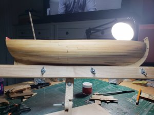

So far it doesn't look bad, but had a decent amount of trouble planking the hull. I think it got better as it went, I started with the top 4, then the keep 4,then the middle 6. I was still trying out new techniques with each set so some parts of the hull looks better than others.

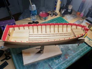

About to add in the thwart risers, the wood is soaking and about ready to be bent. A couple photos are attached of where I am.

Thanks, @Uwek & @BigMike the planking got better and it wasn't too terrible to sand down at the end, there were gaps that needed filling though.
@Maarten I probably should have started with a solid haul ship but I did a lot of reading that this kit was pretty good for novices, and I wanted a little more of a challenge.
In the meantime I've installed the seats and bits for the mast. Really happy with this area, everything lined up nicely and is spaced evenly.
Everything came out pretty level across the seating, I did notice after everything dried that the seats on side are a tad higher than the other but I think that was due to haul construction since all the measurements are accurate. you can't really tell unless you look hard so I'm not that worried about, just a little disappointed since I started my haul at the top to try and avoid this issue. I had two full length strips so the inside rail supports for the seats are one piece and not broken up like in the instructions.
I've started on the seat supports, there's 7 to be done. I don't have a lathe, but im trying to figure out a way to do all of them other than by hand.
The seat across from the mast holder looks like it's at an angle, but again all measurements are correct so either the photo is at a weird angle or the bulkhead isn't square.
After finishing the supports the next thing to do will be the top rail which I have to trace out and cut, haven't figured out how to do that yet.

Here is where I realized just how off the planking is at the top. Because I didn't use a single strip like I did with the cap rail, the plank seems to dip downward to the point where it was cut and then goes back up. This is evident with the fittings, the fittings that go between the cap rail and the seats are nearly flush at the bow and stern but have a gap in center. Unfortunately, something to keep in mind in the future but it's structural and not a lot I could do about it now.
