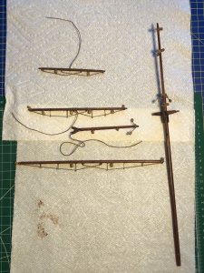

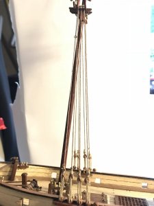

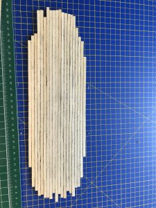

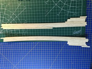

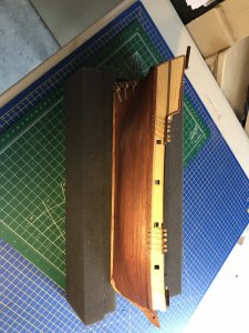

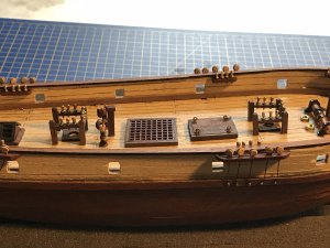

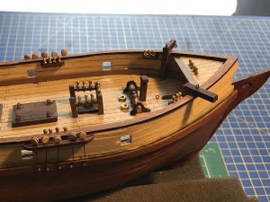

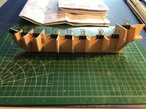

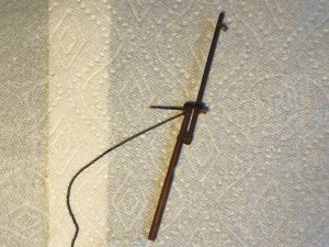

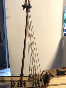

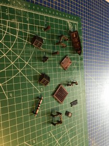

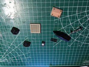

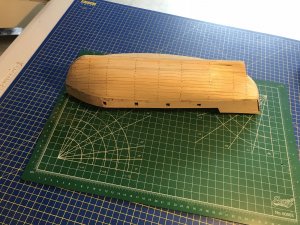

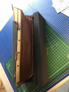

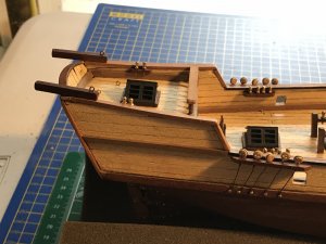

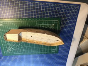

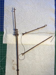

I received the Albatros as a gift over 4 years ago and didn’t have time or commitment to start it. With my recent retirement I have the time and the desire to get back to modeling. I started with a Revell Constitution, 1/96 Scale. It was a significant effort over 4 months but I learned a lot about ships of that period, rigging and nautical terms. I also learned that plastic for me was a bit limiting so I dug out the Albatros and started early September. The pictures I am posting start with the initial stages and go through where I am today. I have learned a lot with this build-woodworking skills, glue and clamping techniques, planking, and ratlines. So far the areas I have enjoyed are 1) building the body of the ship- shaping it and adding the details; 2) assembling the rigging- what a puzzle not only of where things go but the most efficient order of adding the rigging to the ship and 3) building the structures to add to the ship. The only area I have not enjoyed is adding the ratlines. Tedious and pretty boring. I wonder what others have as favorite areas vs least favorite areas of builds? I also think OcCre built a nice kit for moderate beginners. There customer service has been outstanding by providing rigging plans not included in the kit and broken parts replacement within a week from Spain to the US. While I do not have a lot of context I would recommend them. Well here are some pics. Not a piece or art but a nice first build project for me. 507FD464-1492-4E64-A04D-F39A78A7FA2F.jpeg 7B987D0A-7AF5-462D-98B8-7D2A6D320513.jpeg 5653B23E-52A7-482D-8BA1-00D175381F56.jpeg 4E03EA6C-2698-44DD-8111-8BF614700E35.jpeg 6501F793-5BB8-46EB-B764-FACD34CC92F1.jpeg 1F9A4866-0457-4CA3-8AB0-081BB0FC60C0.jpeg 009D017B-549B-45C8-9BB9-99E7AD201DC2.jpeg 3DD38EF1-E574-46AE-81C2-B90D3AF17441.jpeg 8F300DF4-BCF6-4B1B-B804-3FBC9CAA154D.jpeg 39133B0C-B7F8-4189-B0C1-F6452032334C.jpeg 5AA3F717-5575-4CA4-B6E9-9059639C7FD5.jpeg 4966BCAE-7BEA-4332-B57E-026ACDA8C133.jpeg 2D96008E-ECFA-4635-AF81-C5C63E91BB64.jpeg 01562976-F2BA-439E-BFFA-703F72743A83.jpeg 3ACC7C68-AD5E-4C45-B089-BE0E73C716E4.jpeg 6EE66B65-21D7-4D2F-B9C5-E71EE7D3F012.jpeg 082F38B4-190A-40E3-97A3-AFFBF6BA4AA0.jpeg CEB63096-356A-4971-8F88-BE759E6D01C8.jpeg

Looking Good. For me the worst part is planking the Hull, I don't mind the deck planking so much though. my favorite part is the Rigging especially the ratlines. IMO the ratlines make the rigging the better you do those the better the total rigging job looks because they are the first thing that draws your attention in the rigging all the deadeyes and shrouds that are part of that have to be done with care. make sure deadeyes are as close to the same height as possible and none rotated that's a puzzle in and of its self getting those the right way. Pull your lines taunt, but not to taunt you down want lines that are under a load normally to be saggy looking and you don't want them so tight they pull things out of alignment the best method is to tie to the right side then the left for each line and keep an eye on the masts to make sure you not distorting them its a balancing act.

Thanks for the feedback. Agree on the deadeyes. They were all generally aligned until I got to the ratlining and had a couple rotate a bit as I tied them. Learned a lot re ratlining with this ship.

We learn from Doing better then from reading and watching for your first Wood ship build you did a fantastic job and I'm sure you now have confidence to build another the lessons learned on this one will be well served on the next and every build after will get better and better. its amazing how things look great then you do something else and it messes up all your hard work happens to every single Builder regardless of exp. The important thing is not to get discouraged and keep moving forward you will find way to fix thing and some things can wait till the ship is done then you can go back and do what's called Detailing. for deadeyes I will leave them if they rotate then go back when the ships done cut the line between the deadeyes rotate the shroud line at the deadeye one turn at a time and reline it to see if it will hold if not I go another turn, once I'm close I do half turns.
