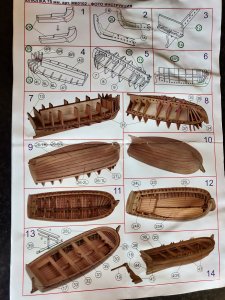

About a month ago I got a letter from HMRC (Her Majesties Revenue and Customs) with a large cheque for an Income Tax rebate. I spent a few days sitting in the garden wondering what to do with this hugh windfall, invest on the Stock Market, buy Gold or splash out on fast women and loose cars. I worked out I could get the 75mm Lifeboat kit from Master Korabel and once the postage was paid I would still have enough left over to buy a bottle of beer and a bag of crisps (potato chips) to help with the build. I like the look of some of the Master Korabel kits but I have always been a bit wary of ordering things from places like Russia or China, so this would be a trial run so to speak. 10 days after placing the order the kit turned up so no worries there then. As expected all the instructions are only in Russian but there is a picture set of instructions and I have been watching a chap on Youtube building the 95mm version so there shouldn't be any problems. I tried my nearby Public Lending Library for "Be Fluent in Russian in 7 days" book but someone else has borrowed it and it's unavailable for the next few months. I have Google Translate on my Mobile Phone and using the camera option I have been able to translate some of the instructions but that's all part of the fun of model building. I will be making a start on this at the weekend and will also be continuing with my HMS Eskimo build

Thanks for that suggestion Dave, I could probably build this just using the picture instructions but there are a couple bits I'm not too sure about,

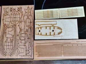

I started on the removable Bulkhead holder, this is 2 pieces of thicker laser cut wood, the fit was perfect without any adjustment required, and I used white wood glue.

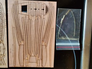

The Keel is also in 2 parts, I cut out the main Keel carefully and using a small needle file I removed the laser char. I did the same with the Stem and then glued the 2 parts together and left for a few hours to dry.
2 small pieces of wood are then fitted, one each side to the front end of the Keel to help locate the ends of the planking strips. These need to be filed down on one edge before glueing into place.

Of course, I will be happy to help you.
But I do not know how I can send instructions to you?
In personal message, I did not see where to attach the file
We do not have the feature to attach files in PMs....sorry

I have now received the English Instructions from Eugene.
Many Thanks for your help, fantastic customer service.
