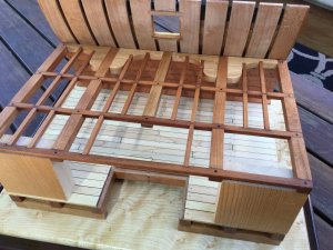

I spent yesterday finishing up the framing of the upper deck. T deck framing.jpg doneframe1.JPG doneframe2.JPG doneframe3.JPG he three of us had a lot of discussion as to the accuracy of the deck framing. In general English framing, each deck beam has a lodging knee and a hanging knee, and all the lodging knees face the same way until amidships, where the knees start facing the opposite direction. This corresponds to the point where the futtocks of the framing reverse, and the floors start facing the opposite direction. The main mast should be located near here also. We came to the conclusion that the framing of the upper deck on this model was stylized, and also altered to accommodate the two lower gun ports. Mike objected to the lack of symmetry, and proposed the pattern you see on the photos. I followed suit. It really doesn't make any difference since the center of the upper deck will be planked over. I've included the plan sheet for the upper deck framing with the other photos.

It is realy looking great.....and thanks for the detailed explanation, understood!
One question:
I the drawing we can see in one field of two beams two half holes on each beam, also visible at one photo on one beam.
What are these for?

Today I cut and fit the hanging knees. There are just three: one each at the two end deck beams and one at the center one. To fit them, they must bear against the hull planking and the deck hangingknees.JPG beam, and the must be notched out for the lodging knees and the deck clamp. I made a template, traced the final result onto my hanging knee blanks, cut out the notches on my scroll saw, and final-fit them with a sanding stick and some files.
