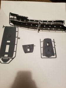

azog
Seaman Apprentice
Seaman Apprentice
Posts: 5
Joined: Wed Aug 23, 2017 7:00 pm
Re: Revell Black Pearl
Post by azog » Mon Sep 18, 2017 5:34 pm
Donnie wrote:
Sun Sep 17, 2017 11:39 pm
Azog,
I will look at model masters and Testors. But i think both of these are the same. They have an online color chart and the last time i visited the site, the color chart was kinda hard to find. If you could do me a favor and take some pictures of the natural color of the parts as is from the box. Is the kit all gray, black or what. In the meantime i will look. The sails in my opinion should have various shades of gray on top of the natural color of sails. The whole ship is
going to have to have a mixture of black and gray tones to it.
Donnie
So all of the plastic in the kit is in a light grey color as the molded color, not black. However there is one small sheet that is all clear but that should not be a problem.
"A ship in the harbor is safe, but that is not what ships are built for." -John Shedd
