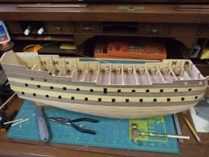

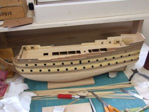

It took about 2 weeks of work to put on the second layer of planks. Most of the time was spent trying to figure out the instructions and drawings. As I spent more time with the directions I was finding this to be the funnest part of the hobby. I've always loved reading blueprints and trying to build things in my head, so I found myself reading those instructions like a good book. The kink you see in the planking next to the keel was corrected.

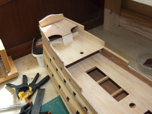

Postby otrax01 » Mon Mar 18, 2013 11:52 pm
I sanded down the second layer of planks and installed the wales. I then installed the Main Deck and it's planking.

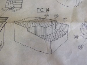

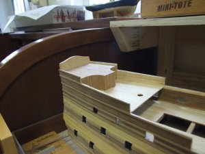

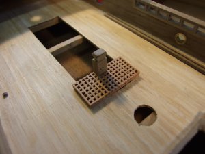

Postby otrax01 » Tue Mar 19, 2013 12:02 am

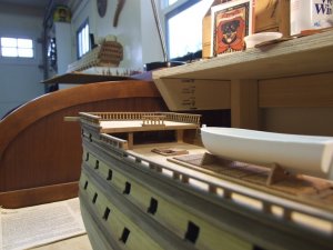

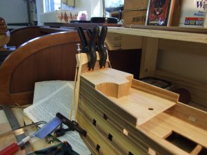

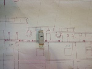

As I was building the Stern Cadtle I noticed that things didn't line up with the drawings. I had built the wall of the ship to long. As you can see in the instructions the two walls should line up. It turned out to be an easy fix. I just had to saw off some of the hull.

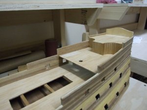

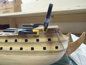

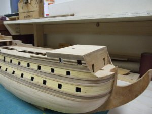

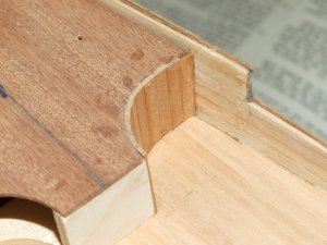

Postby otrax01 » Tue Mar 19, 2013 12:12 am

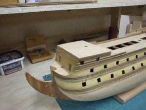

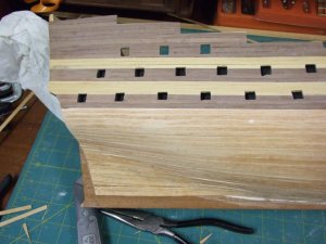

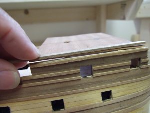

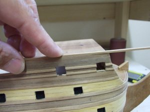

While I was starting on the Fore Castle I didn't like the way things were comming together. I had a pretty good sized gap between the hull and deck. To fix this, I scraped off the wale and the top board the second layer of planking. I glued on a new walnut plank board and I'll replace the wale after I finsh the decking so I can cover the lighter wood edge of the deck.

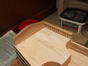

Postby otrax01 » Tue Mar 19, 2013 9:51 pm

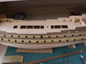

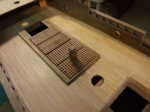

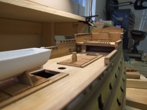

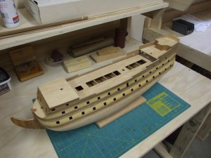

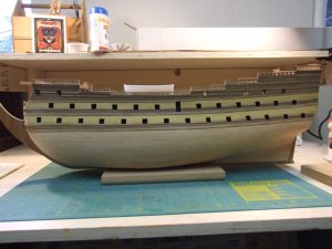

Thanks everyone for taking an intreast in my build. Today I finished all the Bulworks and the planking of the decks. Next step will be handrails.

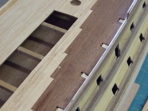

As you can see the seam at the Forecastle deck came out real nice.
