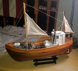

Post by MikeMC » Tue Dec 12, 2017 12:02 pm
Here is my completed Norden from Billings.

Re: Billings Boats: Norden
Post by zoly99sask » Tue Dec 12, 2017 12:30 pm
Looks good Mike,congratulations!
