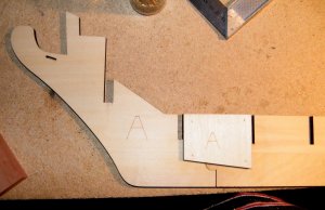

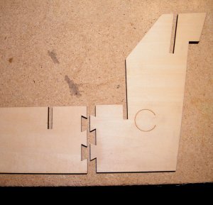

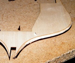

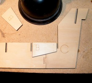

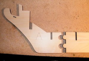

This is the keel set up for joining the stem and keel piece, very nice plywood and a very secure way of locking the parts to-gether
Stern joint
Then there is another two pieces, one each side, which lock the joint really tight
stern pieces.

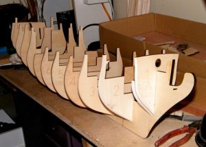

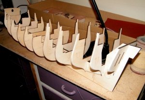

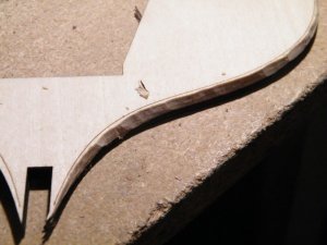

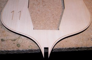

the bulkhead sections are laser cut and along the edge on the bulkhead is a laser line to show how much the bulkhead has to be beveled,
Using a very sharp knife and watching my fingers I pared back the front edge making sure not to cut into the back edge
I then rolled up some sandpaper and used that to finish off the shaping.
From memory I think it was the four or five middle bulkheads had a dead flat and did'nt need any sanding, this view is from aft, all the cut slots were ok with only a light sanding necessary, at this point all the bulkheads were dryfitted.
view from forward

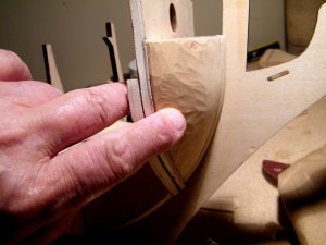

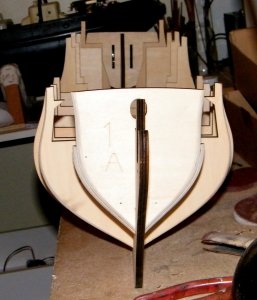

view from head on. Once I had all the bulkheads lined up I clamped a piece of timber along each side of the keel to keep it straight while I glued the bulkheads in place.

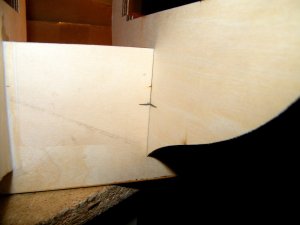

The joints on my RC fit so well together that when I first joined one and went to push it down into place it would;nt go the whole way because the glue coudn't escape, so I marked the bottom of the slot on the keel piece and the top of the slot on the bulkhead and lightly tapped them till they were fully in place. See next pic.
Fully seated in place.

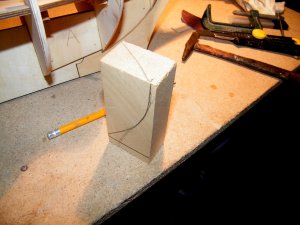

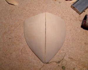

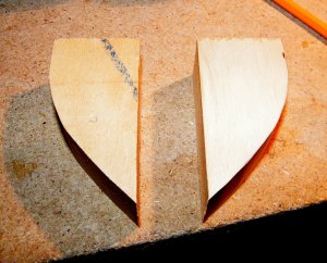

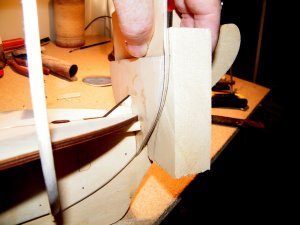

Next up is the bow blocks, these are the only pieces not supplied in the kit, which I do not mind as I prefer to use Jelutong for them, this pic shows a block of Jelutong clamped to the first bulkhead for marking to size, I have also clamped a plank along the side so as to get the correct line for cutting to.
I removed the clamp when marking the back of the block, I also used a template taken off the plywood piece that was attached to either side of the stem.
The block marked top and bottom.
both sides after cutting.

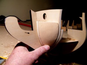

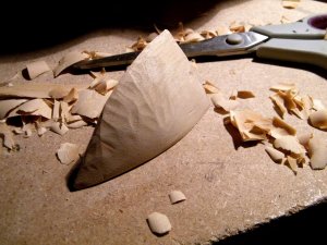

starboard block being carved to shape.
checking for fit
view of both blocks after carving.
Port side glued in place.

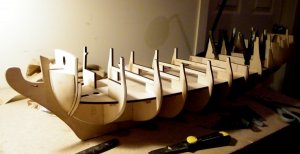

overall view of the build so far.

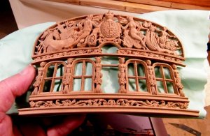

I think thats it for tonight, but just a little teaser of what is to come, I hope you are enjoying the build so far, its a little drawn out but I know new comers to the hobby have a lot of questions and I try to show how things go together,
